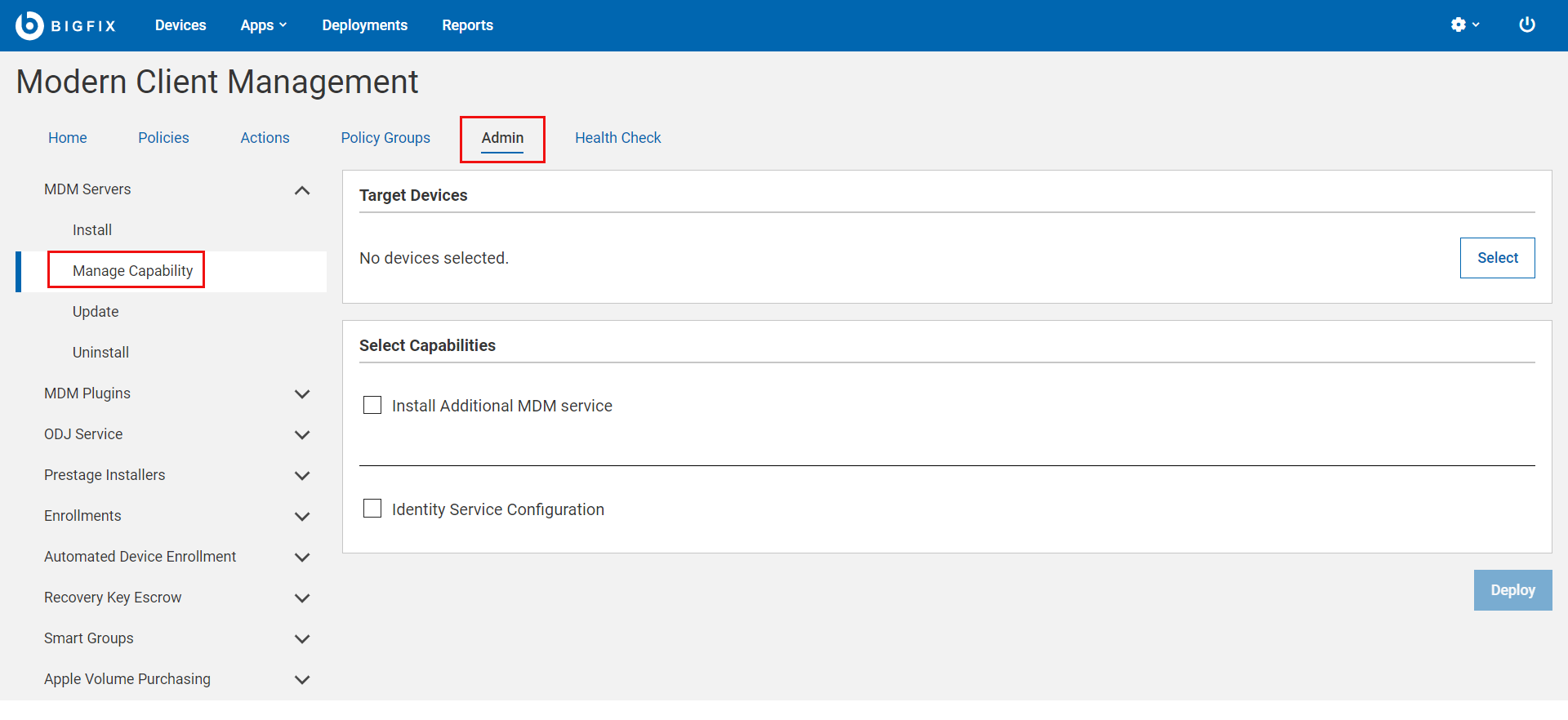

  1. From the WebUI main page, select Apps > MCM.
  2. On the Modern Client Management page, click Admin.
  3. On the Admin page, select MDM Servers > Manage Capability. The following page appears:
  4. Click Select to select an MDM server on which you want to configure the identity service.
  5. Identity Service Configuration

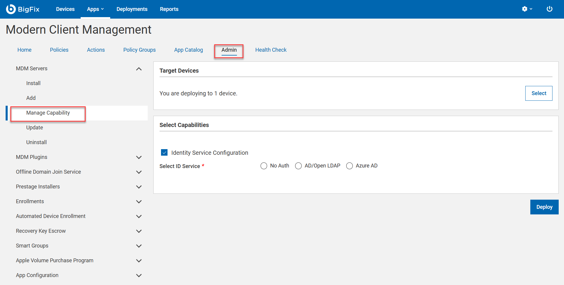

    1. Under the Select Capabilities section, select the Identity Service Configuration checkbox. ID Service options appear for you to select.
    2. Select ID Service
      • No Auth: Select this option if you do not want any authentication. This means anyone can enroll for MCM service without having to identify themselves through user credentials.
      • AD/Open LDAP
        • Enable SAML: This is optional. Select this check box to enable SAML-authentication configuration.
