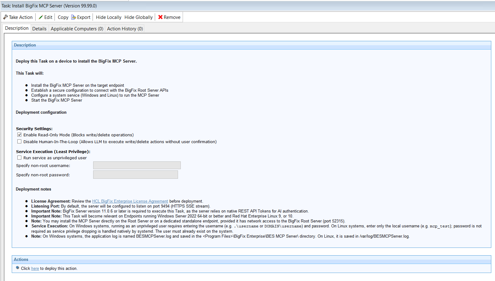

BigFix Platform MCP Server Install Fixlet
Fixlet option What it controls
Run service as unprivileged user Selects the operating-system account used to run the MCP Server service.
Read-only mode Enables the server-side blocking of write-capable operations.
Human-in-the-Loop / disable HITL Determines whether the supported write operations require explicit user confirmation.
Installation Fixlet options
The Installation Fixlet can run the MCP Server service with a dedicated account that is not root on Linux and is not a local Administrator on Windows. The installation action itself still requires the privileges needed to install a service, create directories, and apply file permissions.
Windows: Select Run service as unprivileged user and provide the account in DOMAIN\username or MACHINE\username format. Omitting the domain or machine prefix can cause service installation to fail. The Fixlet adjusts ownership or access control on the MCP Server installation and data directories for the selected account.
Linux: Select Run service as unprivileged user and provide the existing account that will run the service. The Fixlet adjusts ownership of the required MCP Server directories.

Read-only mode option
When the Fixlet enables read-only mode, it writes the corresponding server configuration so that write capable operations are blocked by the MCP Server before they are sent to the Root Server. This is an execution-time control, not only guidance for the AI model. Choose read-only mode for evaluation, discovery, reporting, or environments where the MCP client must not create, update, retry, stop, or delete BigFix objects. For the complete server/client decision logic, see Read-only mode described in Using BigFix Platform MCP Server.
Human-in-the-Loop option
The HITL option controls whether supported write-capable operations require an explicit user decision through MCP Form Elicitation. In the configuration, disable_hitl: false means HITL is enabled. disable_hitl: true disables the server-configured confirmation step. Before enabling write operations with HITL, verify that the selected MCP client advertises Form Elicitation support. If the client does not support this capability, the MCP Server blocks the write operation rather than executing it without confirmation.
