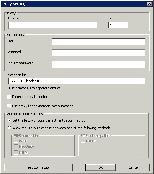

On Windows servers the command BESAdmin.exe /setproxy opens the Proxy settings panel filled in the current proxy settings.
Displays the settings to configure the proxy connection
The same panel is displayed whenever you run the BESAdmin.exe command to set one or more specific proxy settings. Check that the values displayed are correct, modify them if necessary and then click OK to confirm the changes.
