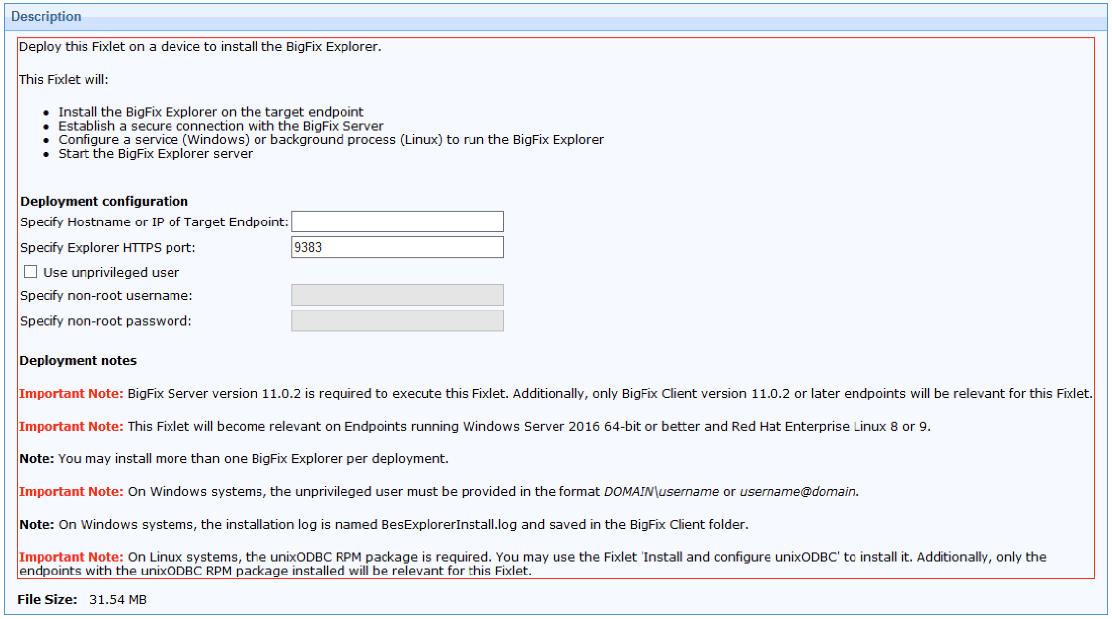

Logged on as a BigFix Master Operator (MO), you will be able to deploy a BigFix Explorer instance in your environment by deploying the Installation Fixlet of the BigFix Explorer, named Install BigFix Explorer (Version 11.0.x), on a target client machine.
You can deploy this Fixlet only from the BigFix Console, not using the WebUI.
In the Deployment configuration section of the Fixlet pane, you must configure the following fields before running the Fixlet:
  • (Mandatory) In Specify Hostname or IP of Target Endpoint, enter the hostname or the IP address of the target client computer on which you intend to install BigFix Explorer.
  • (Mandatory) In Specify Explorer HTTPS port, enter the HTTPS port that the BigFix Explorer should use to expose its REST APIs. By default, this port is 9383.
  • (Optional) Check the box named Use unprivileged user if you want to install BigFix Explorer using a non-administrative user.
  • (Optional) If you have checked the box described above, enter the non administrative user ID and password in the fields named Specify non-root username and Specify non-root password respectively.

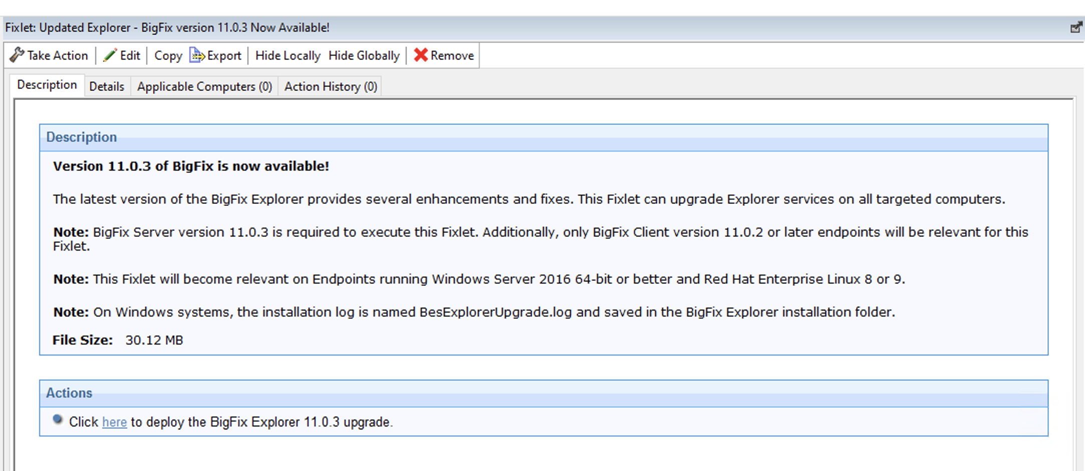

Upgrading BigFix Explorer
Logged on as a BigFix Master Operator (MO), you will be able to upgrade a BigFix Explorer instance in your environment by deploying the Upgrade Fixlet of the BigFix Explorer, named Updated Explorer, on a target client machine.
