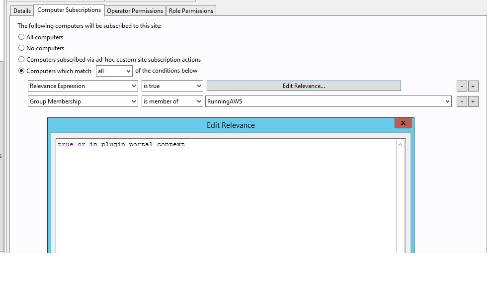

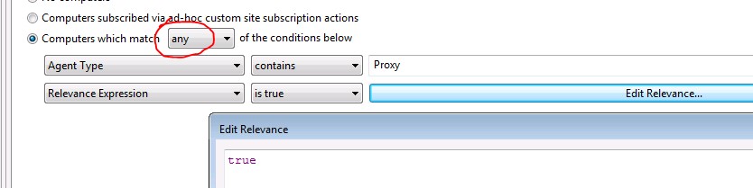

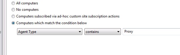

Here are some examples using the Computer Subscription Console tab.
Since the Console resolves the Agent Type condition into an expression that uses the in proxy agent inspector, setting this condition will be enough to ensure that it is not ignored by the Plugin Portal.
- To subscribe only proxied agents:
- To subscribe all the agents:
- To subscribe all agents of the specified Server Based Computer group:
