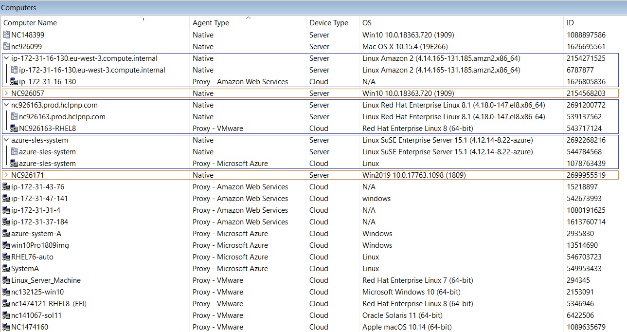

The correlated device is a logical entity, and the BigFix Console shows it as an expandable object in the Computers view. The root element of the object represents the correlated device itself, and has an own Computer ID. The ID of the correlated device is created at correlation time, and typically falls in a range higher than the IDs of the single representations. Correlated representations are shown slightly indented when expanding the correlated device.
In the blue boxes examples of expanded correlated devices, in the orange boxes examples of collapsed correlation computers
The correlated device inherits the properties from all the devices it correlates. In case the devices report different values for the same property, the correlated device inherits the value from the native one as it is the most accurate and meaningful source of data.
  • When one of the correlated representations has not been checking in for the amount of time specified in the BigFix Console preferences, besides appearing itself as offline, it makes the correlated device appear offline as well.
  • The Agent Version associated with proxied computers corresponds to the version of the Plugin Portal that is managing them.
  • The Computer Name of proxied computers discovered by the AWS plugin corresponds to the name of the host taken from the Private DNS Name.

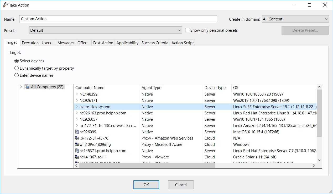

  • As shown in the following figure, an Operator takes a custom action, and in the Target tab, clicks Select devices and selects a correlated device:
    In this case, the BigFix Server dispatches the action to one of the correlated representations based on the parsing of the actionscript commands. If only one of the correlated representations can run all the commands of the actionscript, then the BigFix Server dispatches the action to that representation. If the whole actionscript is applicable to more than one representation, then the BigFix Server always chooses to dispatch the action to the native computer.
    • If the Operator wants to target a specific computer representation, it is enough to expand the correlated device in the Target tab, and select the desired representation. In this case, the BigFix Server sends the action to that representation directly.
