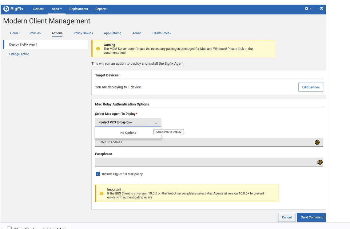

Unable to deploy BigFix Agent, even though the BigFix Installer is pre-staged in MDM server.

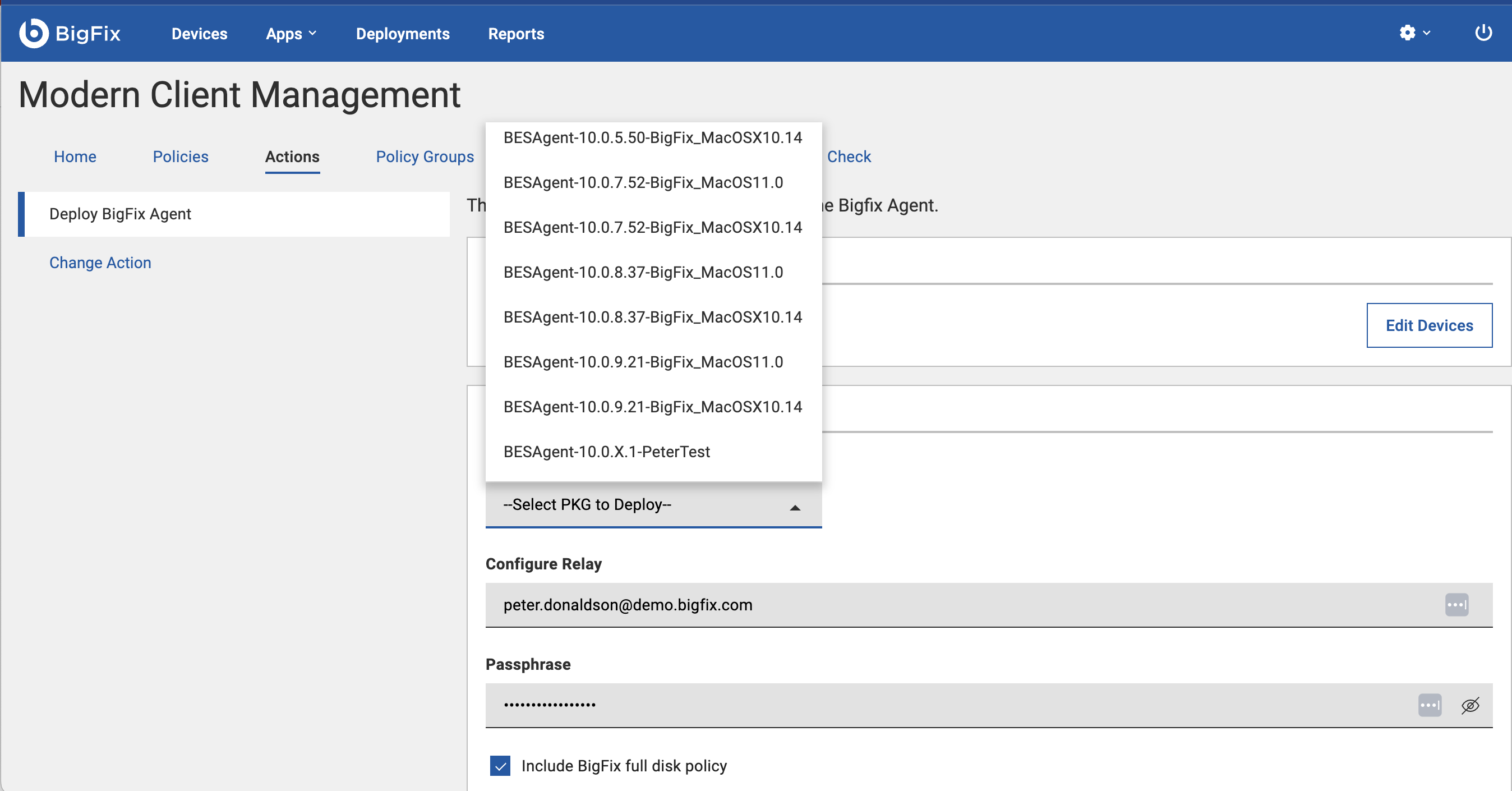

  • While deploying BigFix Agent, the available packages list does not show the latest packages.
    BES Agent packages for macOS
  • Getting a warning when trying to deploy the BigFix agent, even after prestaging the BigFix Installer in MDM server.

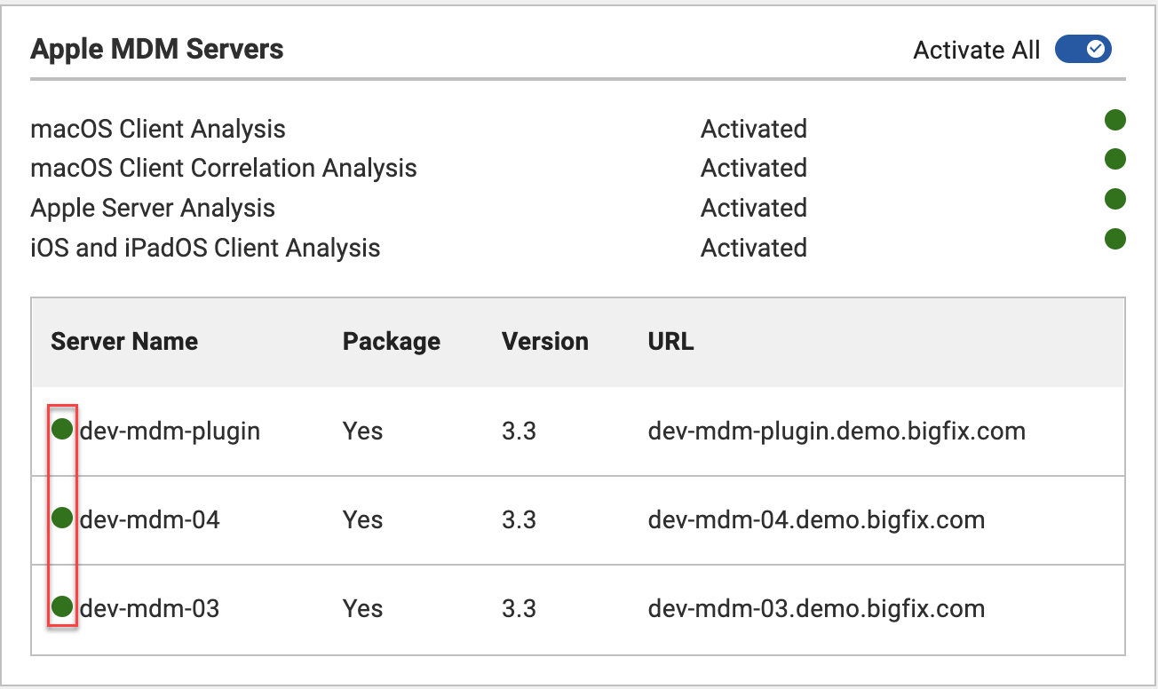

    2. Verify the WebUI health check at
      https://<webUI Host>/mdm/next/healthcheck
      to ensure all MDM servers show a green light and the associated analyses are activated.
