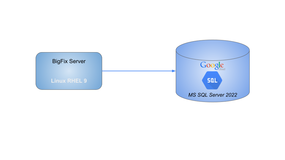

Starting from BigFix Version 11 Patch 2, the Linux Server installation introduces the support of Red Hat 9 x86 64-bit with Google Cloud SQL for Microsoft SQL Server 2022 database.

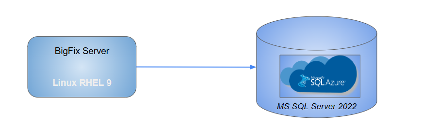

Starting from BigFix Version 11 Patch 4, the Linux Server installation introduces the support of Red Hat 9 x86 64-bit with Azure SQL Managed Instance for Microsoft SQL Server 2022 database.
BigFix Platform Version 11 Patch 2 supports the configuration shown below:
Note that the Enterprise and Standard editions are recommended.
Note: Only the SQL Authentication is supported on the BigFix Linux Server with Google Cloud SQL for Microsoft SQL Server 2022 database.
Note: DSA configurations are not supported with Google Cloud SQL for Microsoft SQL Server 2022 database.
BigFix Platform Version 11 Patch 4 supports the configuration shown below:
Note: Only the SQL Authentication is supported on the BigFix Linux Server with Azure SQL Managed Instance for Microsoft SQL Server 2022 database.
Note: DSA configurations are not supported with Azure SQL Managed Instance for Microsoft SQL Server 2022 database.
