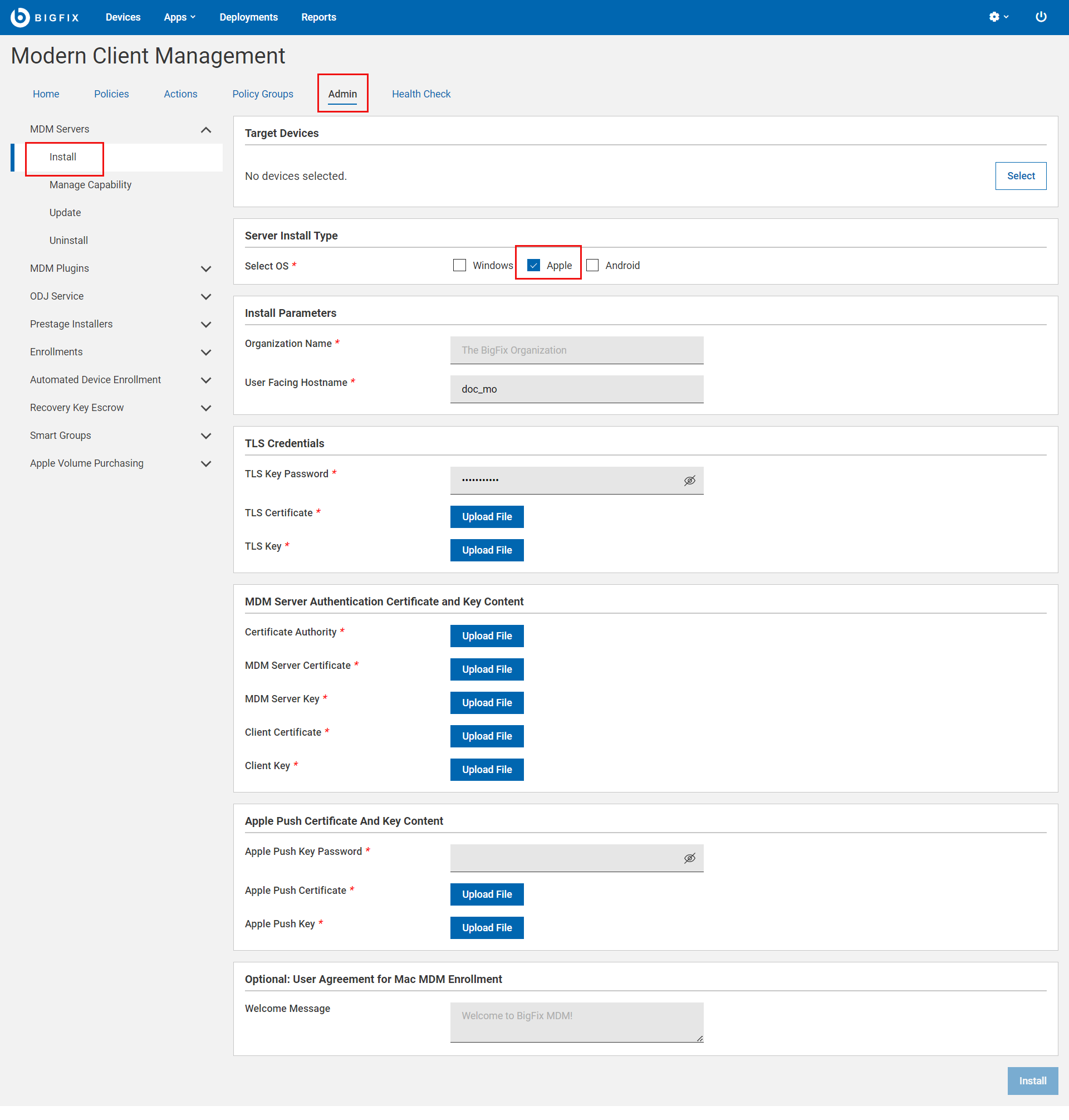

  1. From the WebUI main page, select Apps > MCM.
  2. On the Modern Client Management page, click Admin.
  3. On the Admin page, from the left navigation, under MDM Servers, select Install.
  4. Select Target Device. Click Select and select an appropriate target to install the MDM server on.
  5. Server Install Type: For Select OS, select Apple.
    Install MDM Server
  6. Install Parameters:
    • Organization Name: Enter a string. While enrolling a device, the organization name entered here displayed to the end users.
    • User Facing Hostname: For over the air enrolls, this is the hostname of the server where users can visit to enroll in MDM. The value must be a valid FQDN that is accessible from the Internet. For example, mdmserver.deploy.bigfix.com.
      https:// should not be included here.
  7. TLS Credentials: Enter the details of the MDM Server TLS certificate and key contents.
    1. TLS Key Password: Enter a string to set TLS key password.
    2. TLS Certificate: Click Upload File and browse through the location to select the TLS .crt file.
    3. TLS Key: Click Upload File and browse through the location to select the mdmserver.key that was previously saved. Refer to BigFix MDM Server TLS Certificate Content.
  8. MDM Server Authentication Certificate and Key Content: Upload the MDM Server authentication certificate and key files.
    1. For Certificate Authority, click Upload File and browse through the file location to select the ca.cert.pem file.
    2. For MDM Server Certificate, click Upload File and browse through the file location to select the server.cert.pem file.
    3. For MDM Server Key, click Upload File and browse through the file location to select the server.key file.
      Tip:
      For more information on how to generate .pem and .key files, see MDM SSL certificates.
    4. For Client Certificate, click Upload File and navigate and select client.cert.pem file.
    5. For Client Key, click Upload File and navigate and select client.key file.
  9. Apple Push Certificate and Key Content:
    • Apple Push Key password: Enter the private key pass phrase that was used to encrypt the Push Certificate Private key as described in Generating APNs certificate.
    • Apple Push Certificate: Click Upload File and browse through the file location to select the Push PEM file.
    • Apple Push Key: Click Upload File and browse through the file location to select the encrypted Push key file as described in step 2 at Generating APNs certificate.
  10. User Agreement for Mac MDM Enrollment: This is optional. Enter a welcome message text for users to see prior to accepting enrollment into MDM. The message entered here is displayed to the end users to accept to proceed with enrollment of Apple devices through the enrollment process. This allows the organization to notify or warn device users of the terms and conditions of enrolling their devices. This message can include, for example, a warning about allowing remote management of the device or helpdesk contact information.
  11. Click Install.
