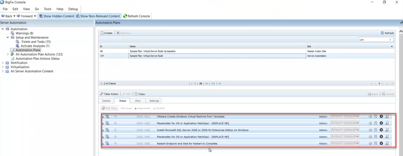

The following image shows a plan with multiple tasks without using the baseline.

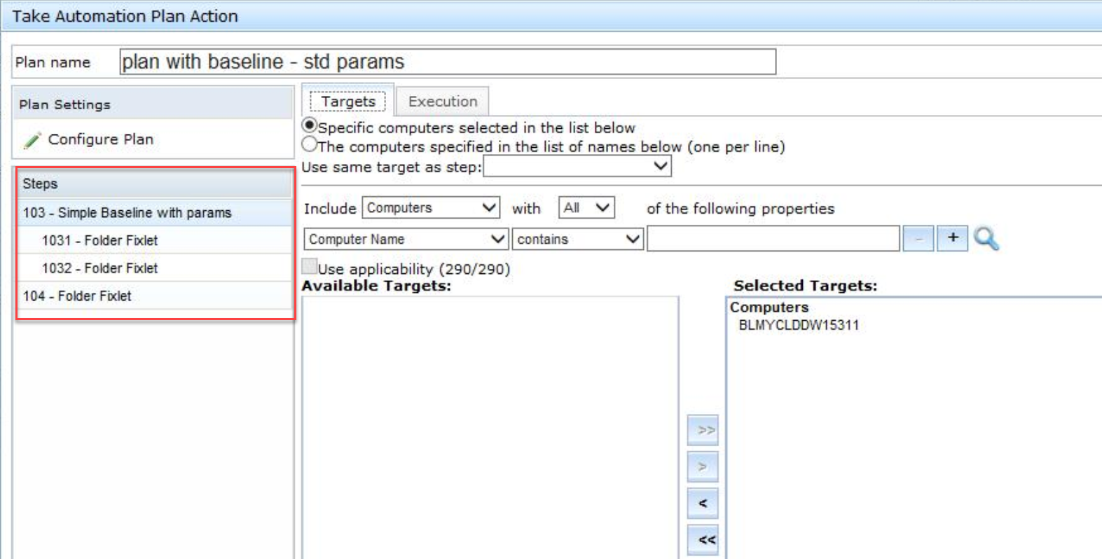

The following image shows a plan with multiple tasks using baseline with parent-child steps.
In this approach, the SA plan gets executed faster than the plans without baseline defined in parent-child steps. Also, you can do the following:
- Create all child fixlet entries for each baseline under a plan.
- On click of the parent baseline step, you can view Targets, Execution, and Failure step parameter(optional) tabs.
- On click of child fixlets/steps under the baseline, view the Parameter tab.
