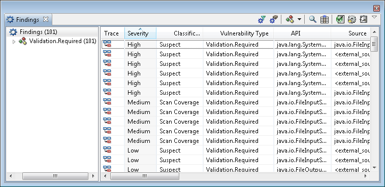

- To create a filter of
Validation.Requiredvulnerability types, click theValidation.Requiredbar in the chart.
Tip: Hold the mouse over the bar to see the number of vulnerabilities.The filtered results appear in the findings table:
- The filtering actions also cause the Filter Editor view to populate with the filter rule settings of the selection that was made in the Assessment Summary view. This filter can be saved in the Filter Editor view (to learn about filter rule settings and saving filters, see Creating and managing filters in the Filter Editor view).

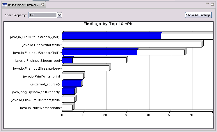

- To view the same filter results by API, set the Chart
Property to API:
